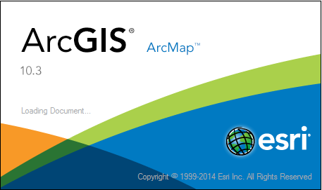

This error message comes right after ArcMap's splash screen. The following screenshot is not from the actual Add-in because the splash screen appears and disappears way too fast and I can't get screenshot.
