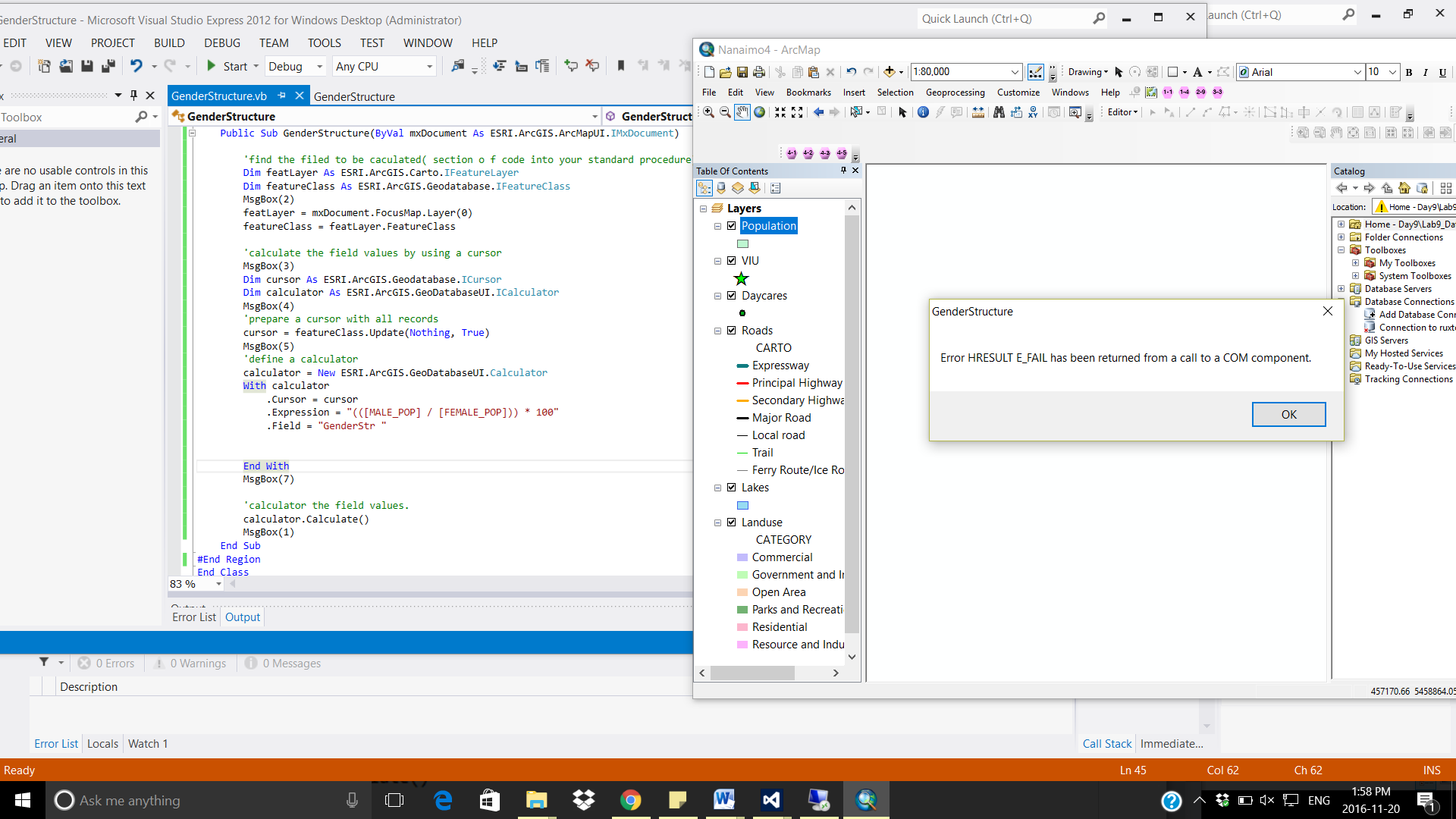

can anyone check the error and tell me why I am getting this error?

I want to create and program an arc map add in commend in vb.net. to calculates a measure of gender structure ((Male_pop/FEAMLE_POP)*100 in a GenderStr field. I am getting an error I have included both my code and error message I am getting. I am wondering if anyone can help me what is the problem to solve this error?

First of all a screen shot of your code will not get you much help.... it is hard to see for some of us older folks..... formatted code will allow us to cut paste and see if we get similiar errors as yours....
In any event .... I put together some pseudo code taken from some of my applications that perform something like you want.... hopefully this will point you in the right path

I agree with tkowal‌, screen shots of code is not a good way of asking a question as the error may be occurring outside what you are displaying and sometimes people mess up with screen resolution so its impossible to read! That said you don't state WHEN the error occurs. You clearly have a bunch of messagebox lines for debugging. This is a significant omission and you need to clarify at which point the error is occurring. Also you give no information about the version of ArcMap or the dataset that you are attempting a calculation on: is it a shape file, personal geodatabase or even an XY event layer?  You need to be much more descriptive if you want us to help you. Suggest you edit your question with this information and get in the habit of supplying that if you need to ask another question.
