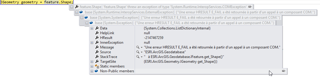

I have the following error when I try accessing the Shape of a Feature in a console application when using a QueryFilter with SubFields.  I am using ArcObjects SDK v10.3 and Visual Studio Express 2012.
The element '{http://schemas.microsoft.com/windows/2005/02/color/WcsCommonProfileTypes}Text' is used but not declared in DTD/schema.
The thread '<No Name>' (0x12f8) has exited with code 0 (0x0).
The Exception is thrown when I do IGeometry geometry = feature.Shape; in the following code.
However if I comment the line where I declare queryFilter.SubFields = "CD_CS_FRA, NOM_OFFCL_CS_FRA";  there is no error.
Edit: Using the debugger I can see this:

JeffMatson
You just need to add "SHAPE" to your list of fields specified in .SubFields
