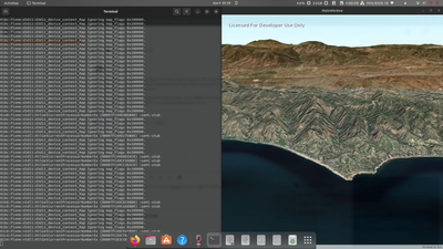

Hey I could do it, there is no issue on running ArcGIS Runtime SDK for .NET on Wine on Linux
ArthurFarias
I am using:
Intel® Core™ i7-7500U CPU @ 2.70GHz × 4
NVIDIA GeForce GTX 950M
Ubuntu 22.04.3 LTS
X11
ArcGIS Runtime for .NET (WPF) 200.2.0
wine-8.19 (Staging)
Vulkan Implementation of DX3D available at (https://github.com/doitsujin/dxvk)
Right now a lot of cross platform gaming projects are using these implementations and wrappers.
