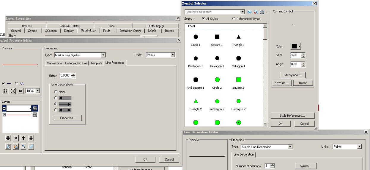

I am trying to change symbol color through ArcObject , but only part of symbol can be change(fig 1.). The setting which is inside in nested symbol setting page (fig2). I use the follow the code below to change the first layer's color.Does any one know how to recursive loop all symbol's porperties? Thanks
//Code
  _MultiLayerLineSymbol = _Symbol as IMultiLayerLineSymbol;
                 _LayerColorLock = _MultiLayerLineSymbol as ILayerColorLock;
                 for (int i = 0; i < _MultiLayerLineSymbol.LayerCount; i++)
                     _LayerColorLock.LayerColorLock = false;
                 _MultiLayerLineSymbol.Color = _Color;
