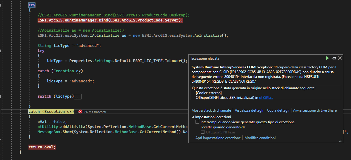

Hi all, I'm trying to recompile an application to use it with ArcGisServer 10.9.1 but I have a problem with AoInitialize method at the beginning (see the picture below). I used it without problem with previous releases.
The error message is: 80040154 Interface not registered. (Exception from HRESULT: 0x80040154 (REGDB_E_CLASSNOTREG)).
Any tips?
TIA

2022-10-28 09_10_14-mRemoteNG - confCons.xml - WEBSERVER9.png2022-10-28 09_10_14-mRemoteNG - confCons.xml - WEBSERVER9.png

Hi, I tried the solution you shared but it still doesn't work (same error).
Any other tips?
TIA
Alder

Hi,
What type of SDK do you use for developing? .Net or Java Windows?
AlessandroValra
Hi @GKmieliauskas, I use .Net SDK
GKmieliauskas
In page, link I have added, is written:
"ArcMap/ArcGIS Engine does not exist anymore with version 10.9 (and above)"
As alternative people suggest use other technologies ("Mobile APIs for the ArcGIS Runtime") .
You can ask @Tech_Mahindra_GISSingapore about his experience in developing with ArcObjects SDK Java for Windows.
