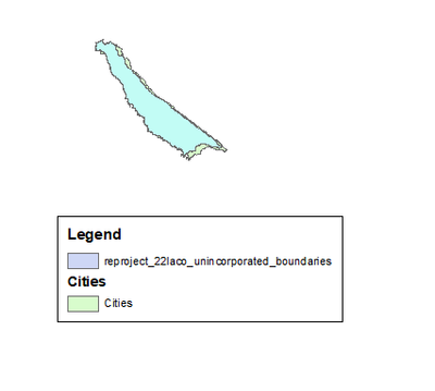

Like the title says, my data will not line up after reprojecting into the coordinate system I am trying to match with another.

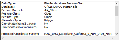

I have an existing layer called AA_Cities and a newly downloaded shapefile called LA_County_Boundaries2022.

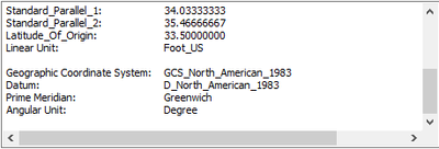

AA_Cities is currently in NAD_1983_StatePlane_California_VFIPS_0405_Feet.

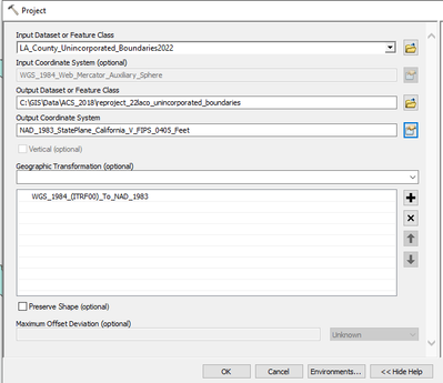

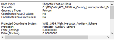

LA_County_Boundaries2022 is being reprojected from WGS_1984_Web_Mercator_Auxiliary_Sphere to NAD_1983_StatePlane_California_VFIPS_0405_Feet.

LA County Unincorporated Boundaries 2022 (downloaded shapefile)
Reproject_22laco_unincorporated_boundaries (Reprojected Layer)
Data Not Lining Up

Could you try a different transformation method, like "NAD_1983_To_WGS_1984_5"?
Transformation methods are bidirectional (works both ways).

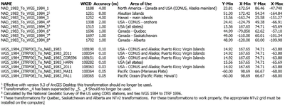

Hi Jayanta thank you for this info it is good to know. I tried your suggestion and the data doesn't seem to move at all. I have tried several transformations and followed the suggestions of the table listed below to no avail.
