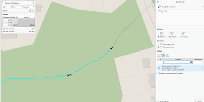

Well, this is a bit of a roundabout process, so I hope you don't need to do it too many times, but it is at least an option:
1. Duplicate your rivers layer to ensure a "master" copy stays intact
2. Use the Split tool and choose "by feature". Use the fish point as the input and the copied river layer as the target
3. Use the Divide tool and specify the distance along the line to split the feature. Do that for both of the new segments generated in step 2
Then you're left with a few new segments: Two on each side of the point you can either export to a new feature class or adjust the attributes to visualize differently than your underlying master layer.
Again, a tad roundabout, but lacking a single tool function to bundle each of these (I recommend submitting an idea if no other community members know of a way to do that), it could work for you.
