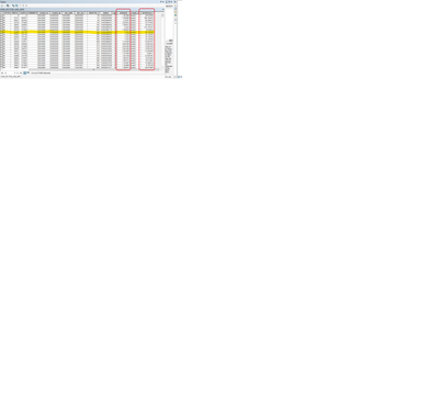

Each point has its own unique distance and angle and they have no real relation to each other.
Attached is a screen-snip of the attribute table.
Each individual row corresponds to a unique point.
For example, the highlighted point needs to be moved by a distance of 1.4725m at an angle of N16.139794W.
As you can see each individual point has its own angle and shift_distance that is unique from the others.
This is why I could not use COGO for this task - Each point has its own unique shift_distance and angle.
Do you know of a tool that can assist with this task?

James_Blythe
Attached is a picture in case the one in the post is not visible.

I see. This requires coding to work with the shapefile, or conversion of coordinates or attribute table to a text file for application of geometry formulas SIN and COS in a spreadsheet or database.
