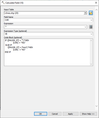

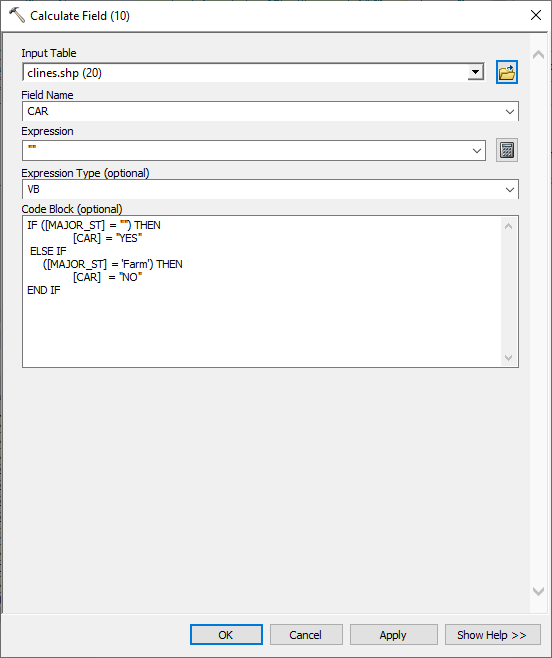

Hi all,
I am trying to populate a Text Field with a 'yes' or 'no' attribute based on the results of an IF Statement and am running into the Syntax error.
I have a field named 'MAJOR ST' in my street centerline table to create classes for my streets. This is the field I am basing the If statement off of. I have added a field to the table called CAR. This is the field I want to populate with 'yes' or 'no'. If the attribute in the MAJOR_ST field is empty, then CAR should be YES. If the attribute in the MAJOR_ST field is 'Farm', the CAR should be NO. This is the statement I came up with but is causing an Syntax error.
IF ([MAJOR_ST] = "") THEN
[CAR] = "YES"
ELSE IF
([MAJOR_ST] = 'Farm') THEN
[CAR] = "NO"
END IF
Can someone help me with this? All I want to do is populate the CAR field with a Yes or No
Thanks

KenBuja
MVP Esteemed Contributor
You have to use double quotes
([MAJOR_ST] = "Farm") THEN

Should my Field type for CAR be Text? I tried your suggestion and it still bombed. Also is my Expression field correct?
Thanks

KenBuja
Change some things on your Field Calculator window.
Expression should be "output"
The Code Block should be
dim output
IF [MAJOR_ST] = "") THEN
  output = "YES"
ELSEIF [MAJOR_ST] = "Farm" THEN
  output = "NO"
END IF
