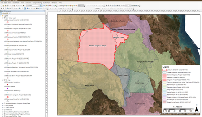

Hi All,
How would I get rid of the all the parts of the layers that don't overlap with the second layer in the legend (grey).
I want to say "clip" but clip doesn't work.

If it's just for visual display purposes, then you can apply a clipping mask in the data frame properties. And exclude any layers you don't want to clip (including the basemap).
Otherwise, if you want a geoprocess to clip all your layers and make new data, then just clip each one in turn and relink the existing layers to the newly clipped versions in the TOC

Great, thanks!
