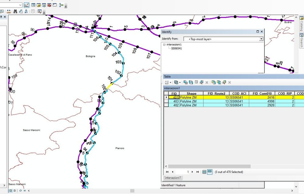

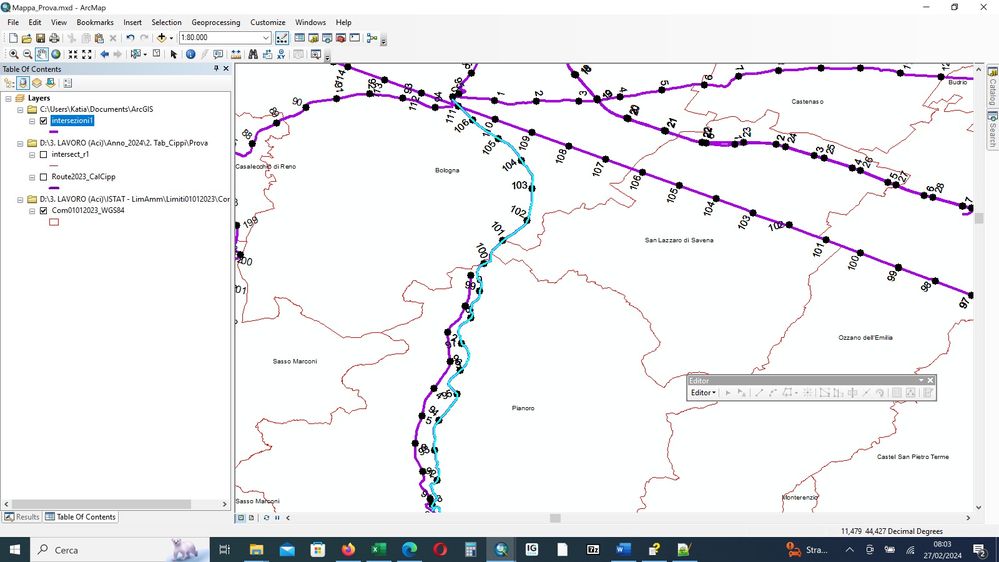

Actually the "problem" is that the original road layer just comprises lines (calibrated lines). and does not contain any table with starting Road Mileage and Ending Road mileage fields.
By using intersect anyway I think I managed to get a new calibrated road layer composed by split routes (i.e. the original route has been split in several segments each one completely contained into a municipality)
Well, now the challenge would be to extract a table containing the starting Road Mileage and Ending Road mileage of each and every segment in this new layer... is this doable?
