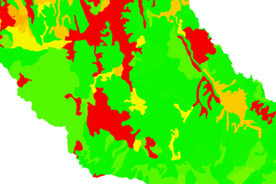

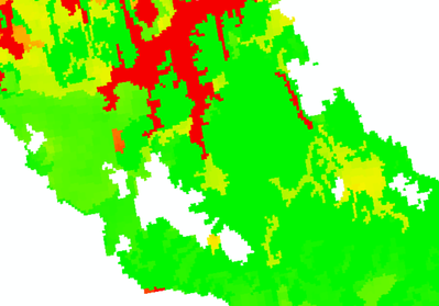

Hello. I have a raster file with some holes in it (Picture 1) and i want to fill these holes from the value from another raster (Picture 2) via overlaying. Note that the resolution of the first raster is 100m*100m and the roselution of the second raster is 5m*5m. Is there a way to do it?

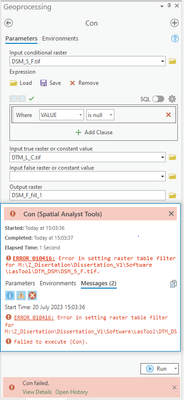

Hi, I have the same problem where I am trying to fill the missing data (NoData) for my DSM with the values from my DTM. I am using the Con tool but I am getting an error message.
