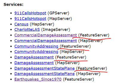

For editing a service, the map document must have been published with Feature Access capability enabled. What is a Feature Service?
What version of ArcGIS Server and ArcMap are you currently using?
In the REST Directory, do you see the Feature Services for the same name (Landbase) or for Easement Service?
Making a local copy of a feature service for editing
To make a local copy of a feature service, it must be published with Create, Delete, and Update capabilities enabled.
Also ensure you add the feature service to ArcMap from a User connection, and not from an administrator connection.
I maybe able to provide more info., if the current working version of ArcGIS Server and ArcMap is known. It would also help if you could provide relevant screenshots from ArcGIS Server and ArcMap (Workflows, Services, Editor Capabilities, etc.)
