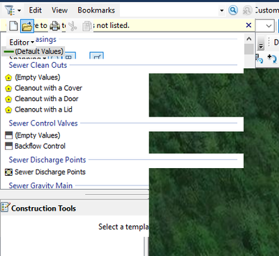

I am using ArcMap, ArcGIS Desktop 10.8.2.

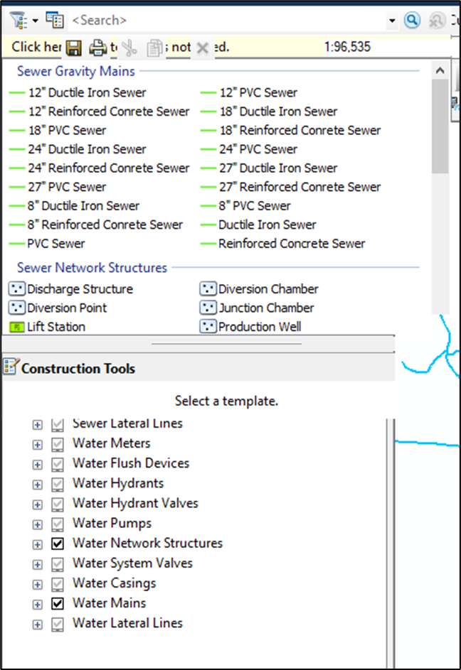

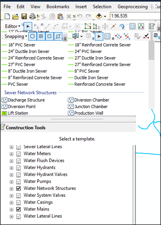

Whenever I need to editing window, Create Features, I get this window. It is somehow morphed into the background, now allowing me to do very much with it.
One of the few things that it lets me do is create features that are already in the system unless they're at the top of the window. When I go to the top of the window, the buttons pop up like this:
The window also hides anything in the ToC that's behind it. I cannot click the button to add new templates, either, so I am unable to add any new features to my map.
Is there a way to fix this?

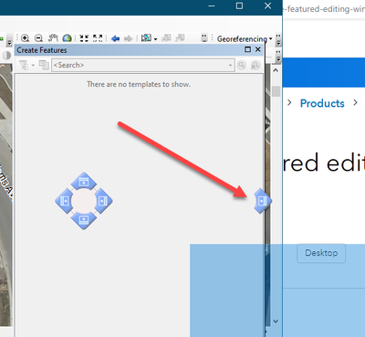

are you able to drag the Create Features window down and drop on the arrow that appears at the right of the screen?
R_
TimG_OWWSB
Unfortunately not. The buttons up top prevent me from moving it at all. They appear whenever I mouse over them.
