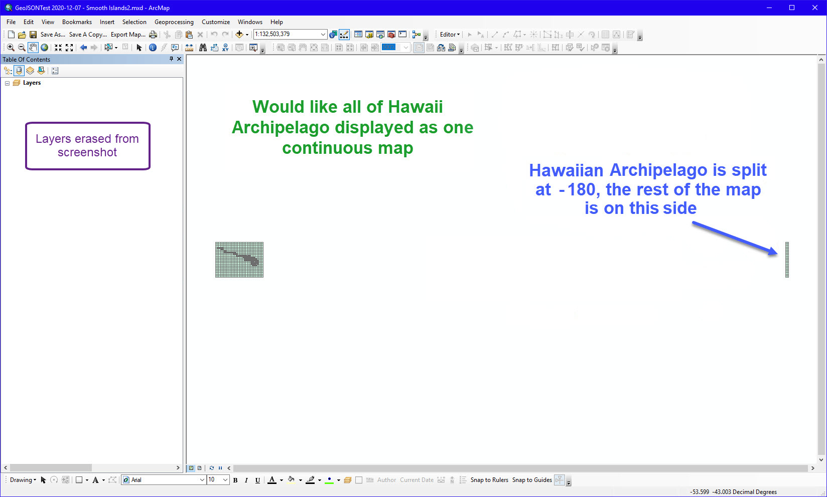

The islands and atolls of the NWHI are on the same side of the International Date Line as Hawaii but the expanded boundary of the monument crosses the date line.  ArcMap is splitting the map at -180, the Date Line, putting most of the archipelago on the left side of the Data View screen and the rest of the archipelago on the right side.  It also prints and exports in GeoJSON like that.
I'd like to center the map on the archipelago and monument boundaries and make the map continuous even though the date line crosses through.  How do I do this so that the Date Line doesn't split the map?
Attached are screenshots of the layer in Data View and a little reference map of that part of the world showing the Date Line crossing the expanded boundary of the monument.

Solution: Change the data frame projection to PDC Mercator, a Pacific-centered projection.  PDC (Pacific Disaster Center) Mercator centers the view on the Pacific.
About PDC Mercator: http://epsg.io/3832.
I found the solution on GIS StackExchange: https://gis.stackexchange.com/questions/234857/un-splitting-data-that-crosses-antimeridian-in-arcmap.  This is exactly the same as my issue and the solution worked.
In ArcMap 10.6, PDC Mercator projection is found here: Data Frame Properties > Coordinate System tab > Projected Coordinate Systems > World > WGS 1984 PDC Mercator.
