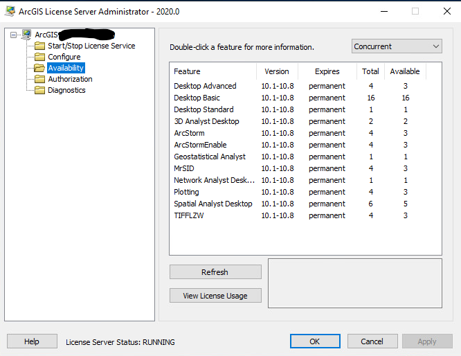

Good day,
My apologies if I'm posting in the wrong location. I work in ICT Technical support and have been tasked to migrate our existing ArcGIS licenses to a new server as part of our cloud migration. Unfortunately, neither I nor my GIS colleagues have performed this task before. I would try to contact ESRI support for assistance, but unfortunately, our parent department (we are a parastatal organization) provided our concurrent, permanent licensing and due to budget cuts was unable to include us in their new licensing/support contract.
I've followed the instructions from the ESRI website on transferring licenses from one License server to another but I keep running into an issue when attempting to transfer more than one. (i.e.: I can transfer 1 ArcGIS Desktop Basic license and it works but as soon as I try to transfer any more than that, it fails). I was hoping that someone in the community has come across this issue before and can perhaps provide a bit more info as to what I'm doing wrong and/or point me in the right direction to find out what the issue is. Granted, our software is outdated (ArcGIS Desktop 10.8.1) but while we await funding for our own licensing/support contract, this is what our GIS Scientists and Technicians have to work with. Below is a screenshot of the licenses on the current server that need to be transferred. Any assistance will be very much appreciated.

ShaneONeill_144
What error/failure are you getting when you try and transfer your licenses?
Before you can transfer licenses from one License server to another, they will need to be deauthorised from the old license server before they can be authorise again to the new one. Please take a look at the below documentation regarding this, it should be helpful for you.
