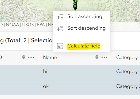

Went to the Web Editor interface and use the above, used the above map. The table offers me to Calculate a field for selected records:

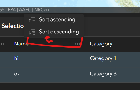

However, the field Calculator is not available in the app:
Am I missing a setting somewhere or is the function not supported?

You’re right — the field calculation tool isn't supported in the Web Editor Instant App template yet. We’re working on adding this in a future update, so stay tuned.
