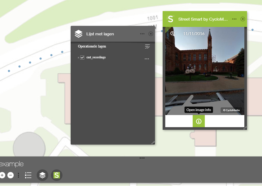

The Dart Theme uses:
.jimu-widget-frame.jimu-container * {
    color: #ffffff !important;
    outline: none;
  which causes strange behavior of our own color css styling:

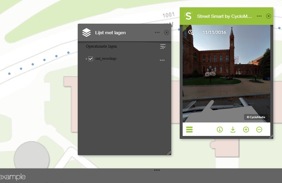

If we remove the * and !important it looks like this:
Dart Theme is the only one causing problems like this. What can we (or ESRI) do about this?

Gijs,
   So in your code for your toolbar at the bottom of the widget you need to have a css rule with higher specificity that will use !important to override the
So hopefully your toolbar as a class applied to it and you can just add a rule to it
This is not just copy and paste code, it is just an example of a higher specificity css rule.
.jimu-widget-frame.jimu-container .mytoolbar.button {
    color: green !important;
