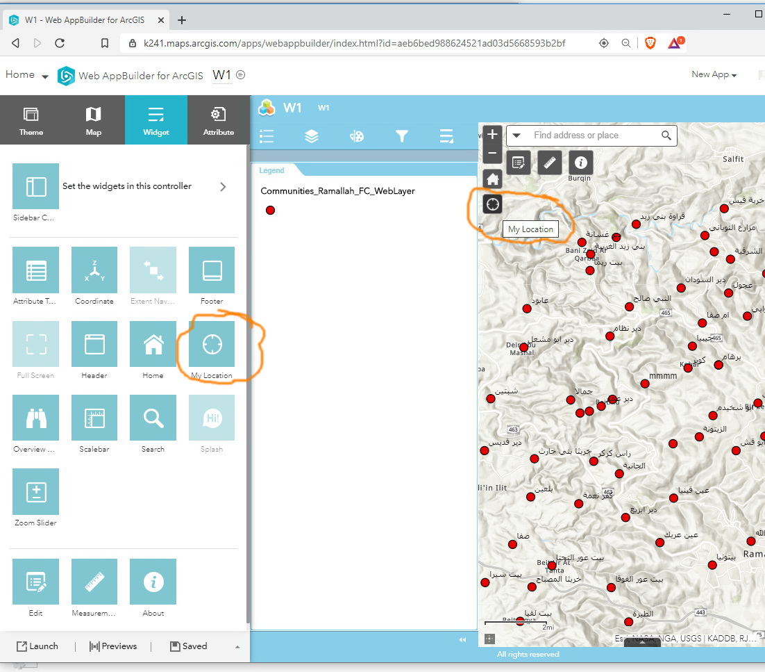

I couldn’t figure out why the “My location” tool fails to work

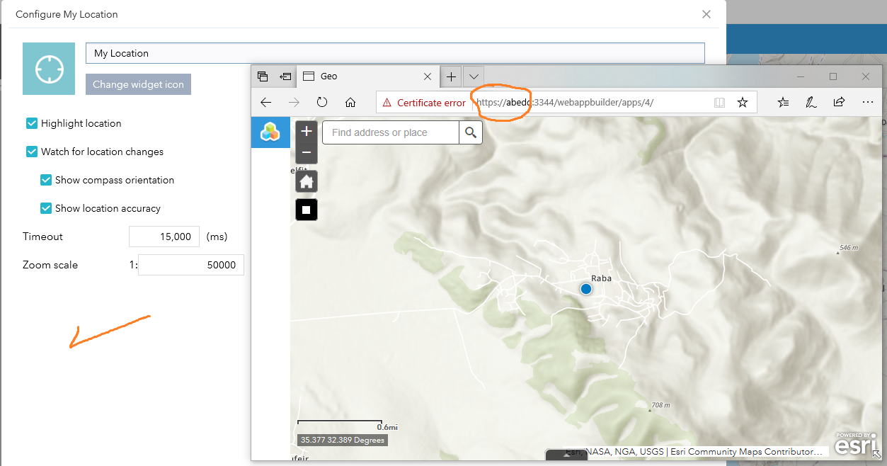

Hi Jamal NUMAN,
Did you check this page?
My Location widget—Web AppBuilder for ArcGIS | Documentation
There are security considerations. Could this be your issue?
Caution:
There are security considerations to consider when working with geolocation. The My Location widget is only supported on secure web pages (HTTPS). All your content must be served via HTTPS, and you cannot mix HTTPS with non-HTTPS content.
HTH,
Egge-Jan
abdullahqasrawi
Its working well with me, check your link and web map must be called by https protocol
