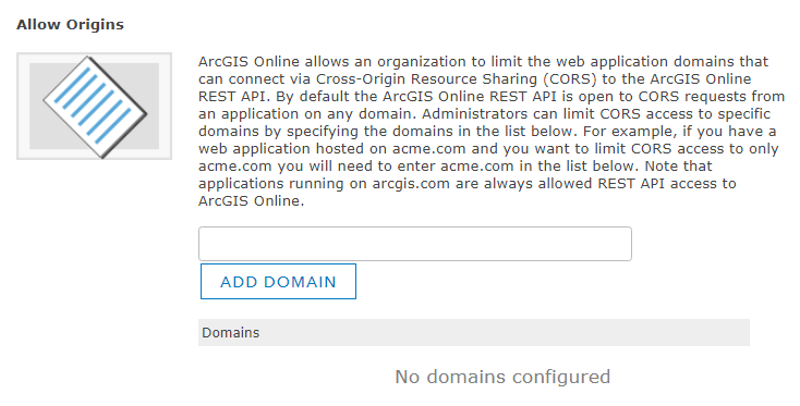

Although for me it was AGOL and not Portal, I just posted this a few places..in case it helps...
I'm adding this possible resolution in a few threads since I just spent about 3 weeks with tech support trying to figure out the constant redirect back to the page requesting my AGOL URL.  I hadn't fired up WAB for a few months, so not sure if happened at the July or Sept AGOL update (not related to the version of WAB) and most likely was something I did (maybe a new AGOL option I think I needed?).
On the AGOL Security page, I had my ArcGIS Server machine listed in the "Allow Origins" dialog.  Once I deleted the Domain I had listed, all worked again.  Just another thing to check if the other suggestions do not work.  May need it in the future (CORS related) but right now, leaving it blank is what is required for us.
