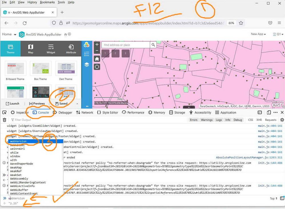

I couldn’t figure out how to identify the version of web app builder
Jamal Numan
JamalNUMAN
Legendary Contributor
I got the help for the forum
  • Open the WAB
  • Press F12
  • Go to console tab
  • Type wabVersion
Jamal Numan

AyanPalit
@JamalNUMAN WAB in ArcGIS online is version 2.25. The listing is available at:
ArcGIS Web AppBuilder Release Versions
Ayan Palit | Principal Consultant Esri
