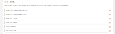

In the item that contains your appId, did you add a redirect URL for your machinename.domain?
MattChomicky1
I did do that
