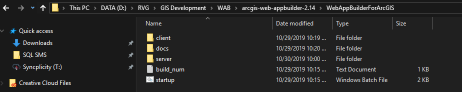

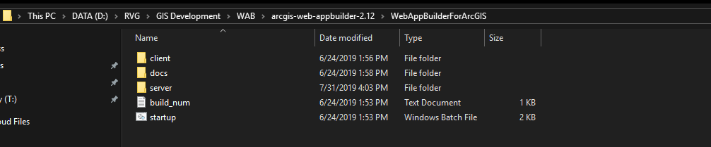

That path you have in quotes now, does it have the client, server, docs, folders directly inside it or is there another sub folder?
RVG296
Robert Scheitlin, GISP
Yes, it has everything. Its the same folder structure for both 2.12 and 2.14.
Below are all the 3 folder structures.

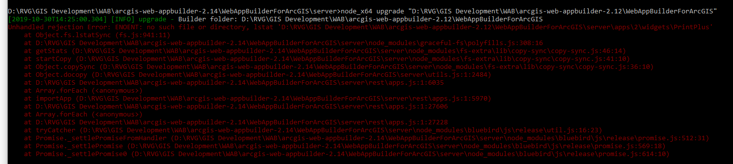

Ok this time its a new error.
Earlier I had a widget called Printplus widget and now I deleted it from the app since I am not using it.
Did this by chance mess up my config.json file which might me causing this issue.
So is that something causing this issue?

Are you saying you deleted the whole PrintPlus folder from the widgets folder?
RVG296
Yes exactly. That's what I did. But I assume once I published for testing, the config.json would have been modified due to that.
Directly deleting the widget would have caused some reference errors. Is that the issue you think?
RobertScheitlin__GISP
MVP Emeritus
Yes. You should have removed the widget from each app that referenced it in WAB dev widget page and saved those apps then their configs would no longer reference it. Then it would have been safe to delete the widget from the file system, but really there was no point in going that far.
