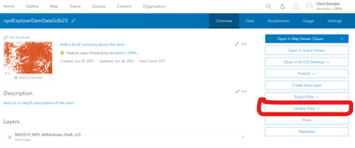

ChrisD
I think you can also use the Update Data option in ArcGIS Online on the dataset page for whatever layers you need to update.
