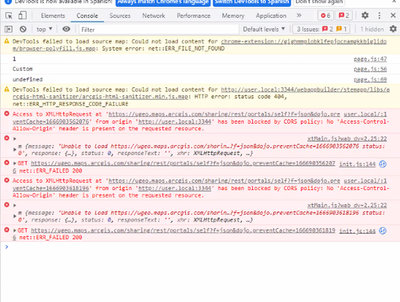

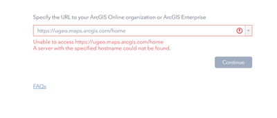

Hello, I've been trying to install ArcGIS Web AppBuilder for Developers, but as soon as I introduce the url of the organization I get the following message:
I've already tried the recomendations of the article. Problem: Unable to access the ArcGIS Web AppBuilder page after specifying a portal URL: https://support.esri.com/en/Technical-Article/000025986

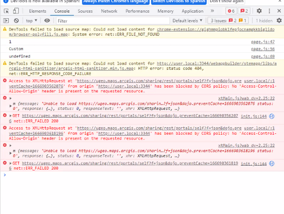

But they did not work, I've also tried on a different computer, with different networks, but it still does not work. The console says the following:
I dont know what else to do. Any recomendations?

Hello, I'm using ArcGIS Online and I'm using the latetst version of WAB Dev

@Anonymous User  It appears that you have not registered your web appbuilder  developer with your ArcGIS Online organization..Kindly refer Step 2 in below link to register or add as item to ArcGIS Online organization-
https://www.esri.com/about/newsroom/arcwatch/configure-web-appbuilder-for-arcgis-developer-edition/#....
