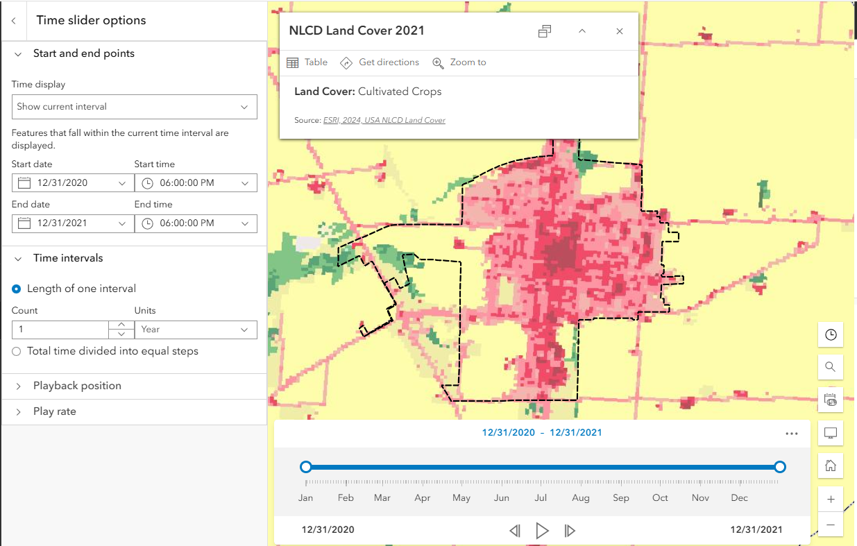

I am attempting to use the USA NLCD Land Cover layer from ESRI to create a map in Map Viewer. This is a time series map. I am using WebApp Builder to try and create the experience I want for my users, but it's not allowing me to put in a Time Slider widget. Ok, fine - ideally I'd be able to include the slider, but I can still get what I need if the map would just stay on the most recent year (2021). Instead, it always defaults to 2001.
I have tried going into Map Viewer and adjusting the time slider options so that the start date is 12/31/2020 and the end date is 12/31/2021 and the Time Display is "Show Current Interval."
I save it, go back to my map in WebApp builder, and it's back to 2001 (I can tell because of the pixels). Is there any way to set the map so it will only show 2021, or is there a way to get the Time Slider in WebApp Builder to show up for this layer?
