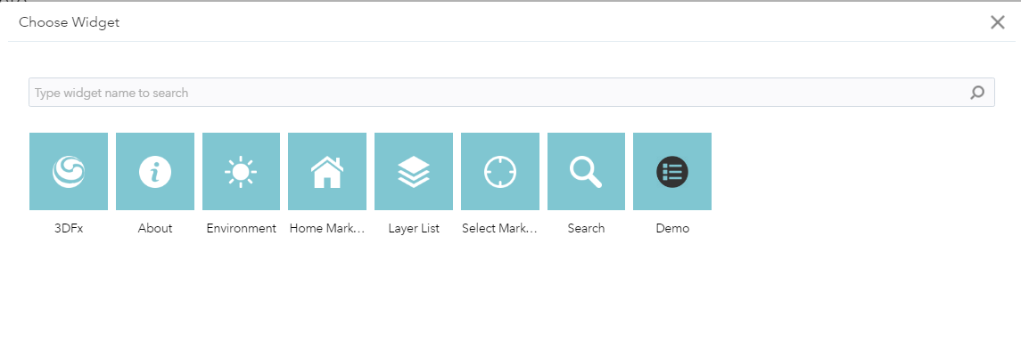

Hello All, i know this is dumb question. I have a 3D custom widget named Visualizer which was developed from the demo sample widget. I have changed "demo" to "Visualizer" in the manifest.json, Widget.js. setting/setting.js. But when I was adding it, it still shows as Demo - please see below. Where else i need to change? Thanks.

Alex,
   Check the nls/strings.js file somethimes there is a widget label property in there.

Alexwang
You are absolutely right, Robert! Solved.
