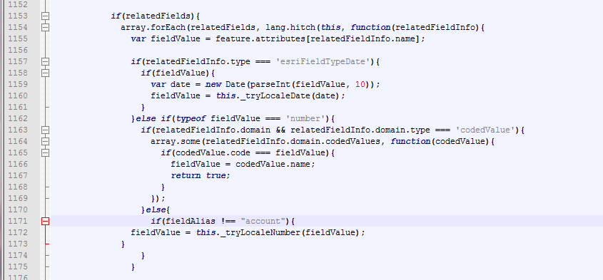

LianaSmith
Robert, I changed the code and now the query fails..Could you please check if I did right? I dont know Java Script, so I am not sure if I did it right
RobertScheitlin__GISP
MVP Emeritus
Liana,
  What error do you see in your browsers web console?
