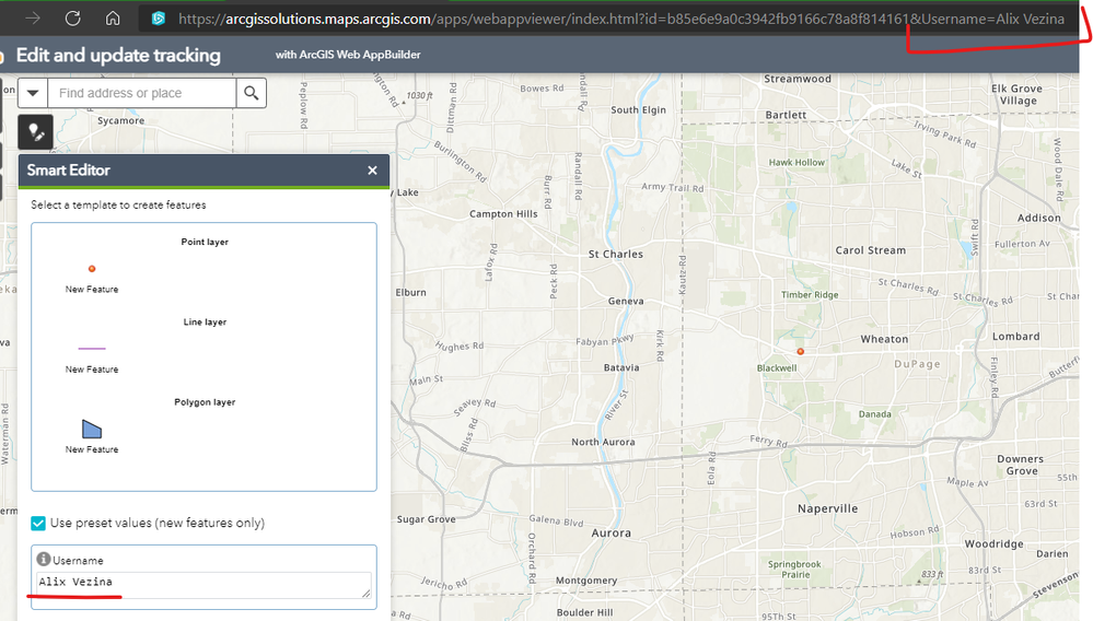

The Smart Editor does not currently provide the capability to grab and populate the username into a new target field, but you could provide an option for the user to manually enter their name or user name.
You can set up a Preset as shown below and pre-populate the username in the URL parameter for the person who will be editing in the app. This value will be written into the field of your choice for all newly created features.
HélèneTouyéras
Thanks @AlixVezina! While this cannot fit my use (too many unknown users: no way to build custom URLs for everyone), it is an excellent solution that I will use for use cases where the choice list is short & bounded.
