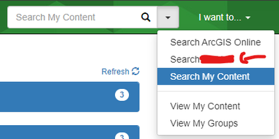

You can find webmaps in your organisation by changing the search parameters through the search box drop down arrow:
I can't think of another way of doing it out of the box without having to redo all your layer configuration.
