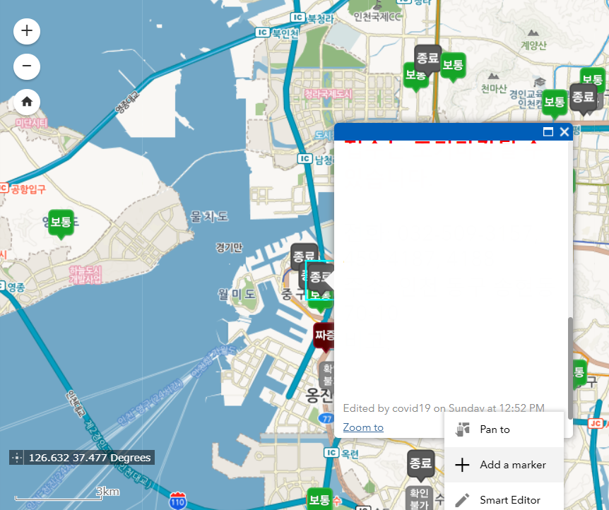

Here is how to find "Add a marker."
1. Click any point feature to see a pop-up on the web map included in Web AppBuilder.
2. Click ... on the pop-up.

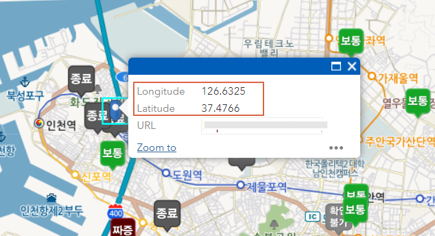

3. Click "Add a marker" and click the blue pin created.
You can see the Longitude and Latitude of the pin point.
