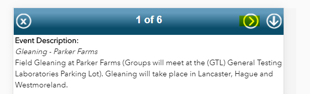

The navagation bars in the mobile popup are failing.
After navigtion button clicked I get the following.

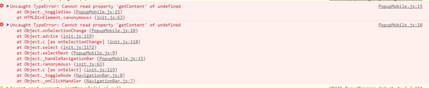

I get the following nasty error message:
I think the error orginates in the PopupManager the  _onSelectionChange Event  (line 99)is not firing as it should. The _onSelectionChange Event calls the  this.initPopupMenu([this.selectedFeature]); (line 121) with the selected feature.
I can tweak the work flow by running the app in a full broswer window and the reseting the window in Chrome Responsive tools for mobile and the mobile popup will behave as it should. The_onSelectionChange Event gets fired every time the navigtion button on the popup gets clicked and I get the expected results.
If I start the app with the  Chrome Responsive tools for mobile set the onSelectionChange Event does not get fired.
It looks like the  event is wired on line 96  on(this.popupUnion.mobile, "selection-change", lang.hitch(this, this._onSelectionChange)); But I can not fiquare out why the binding would not be working or if it is failing.
