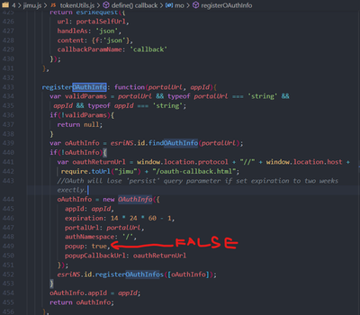

Following up on this issue, and many thanks to Roger Clavero at Esri BeLux for providing the work around for this.
The above is the expected out of the box behvaviour. However, it can be overriden by doing the following in the application.
1. In the downloaded application, navigate to jimu.js folder > tokenUtils.js.
2. Search in the file for the "popup: true" in the OAuthInfo class initialization.
3. Change the value of popup to "false"
4. Save the file
5. Now test the deployed application, it should redirect to the SAML login page without any popup

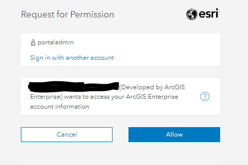

This solution removes the first "Sign In" popup, but how to disable the next "Request for Permission" popup?

How can we disable the second popup where it asks to allow or cancel?
