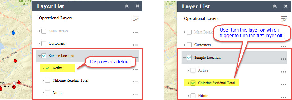

Have anyone know if there is a way to configure a dynamic map server with 3 sublayers, the first layer is active as default. if a user turn on the second sublayer, any displays sublayer within this "Sample Locations" map server will turn off? I don't want a user to manually have to turn off the displays "Active" layer.
Thanks,
Ha Thach
