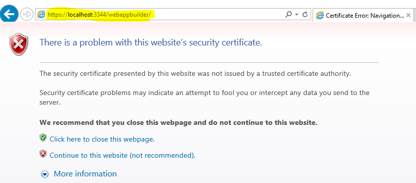

I am trying to run WAB-developer edition 2.10 using HTTPS because my portal is installed on secured environment. After running "startup.bat" from installed location i.e "C:\WebAppBuilderForArcGIS\",I tried to access developer edition using HTTPS but getting below exception.
Any help would be appreciated.

I get the same message when I work with WAB dev. I just click the 'Continue to this website (not recommended)' and it works without a problem. It will be interesting to hear what other people have to say

I tried to run WAB dev with 'Continue to this website (not recommended)'  but failed to register secured portal url and app id.
I have specified portal url and hit continue button. I got below exception on browser.
