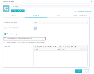

Hi Veronica,
Did you mean the print report or the runtime report? If it is print report we have an option in Download tab, when checked that will collapse the rows that have 0 values in all the configured fields, Could you please try that option and see if that solve your issues.

Hi,
Thank you for your suggestion; yes I have tried checking this box as well, but all layers are still returned even if no results are in the area. This happens for both the initial report that appears in the sidebar after entering in the buffer distance, as well as when selecting print report. I was curious if it was a bug, or something I'm not thinking about correctly?
AzizaParveen1
It is only supported in the print report not in the side bar report currently. Is you app publicly available? If yes, could you please share the url, I would like to see if this is a bug.
