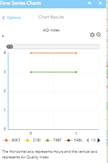

I am using a chart widget  to show time series data in my application created through web app builder . It looks like this currently.
When i open the widget the slider only shows up to 4 values and there are no labels on the x axis and y axis. I want that whenever the widget is opened the slider should have the full extent and labels should also be there. I was able to do it with Infographic widget  which looks like this :
I tried changing a lot  of settings for chart widget within the conf.json file of my app but nothing worked. Here's how both widgets look like in the conf.json file of my app :

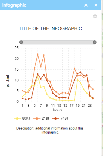

Infographic Widget

What setting of Chart Widget should i change to enable labels of axis and full extent of slider?
