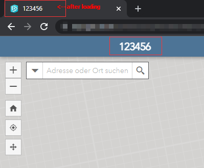

I have a WAB-App downloaded and deployed on a server and would like to change the browser-tab-title independet from the WAB-Title.
Rightnow in the config.json the WAB-title is defined as "title": "123456". I would like to set the Browser-Tab-Label as "ABCDEFG" independet from the WAB-Title "123456".
Changing the title to <title>ABCDEFG</title> in the index.html does not work - loading the page will first show the Browser-Tab-Label as "ABCDEFG" but then quickly change the Browser-Tab-Label to "123456". Inspecting the html head with browser-developer-tool showes <title>123456</title>. So I guess the index.html configuration is overwritten by the title set in the config.json ?!
Is there a way to interfere / decouple ?

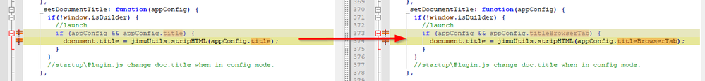

What I did -
In config I added a new item "titleBrowserTab" and set it to the browseer tab title I want,
and in jimu.js/ConfigLoader.js lines 223 to 224 I changed
from:
if(appConfig.title){
  document.title = jimuUtils.stripHTML(appConfig.title);
to:
if (appConfig.titleBrowserTab){//mlev_modified. was appConfig.title
  document.title = jimuUtils.stripHTML(appConfig.titleBrowserTab);

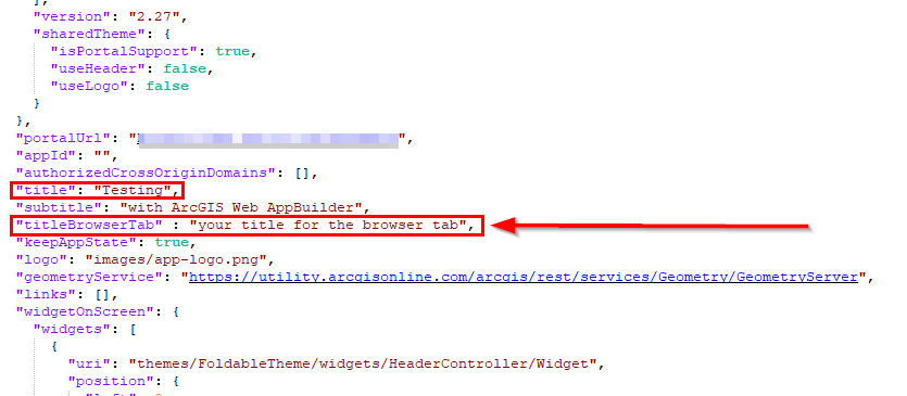

  • Download the Dev-WAB-App
  • Add "titleBrowserTab" to config.json
    • unzip downloaded WAB-App
    • open with an editor "../yourapp/config.json
    • seach for "title" or "subtitle" and append a new line with the "titleBrowserTab"image.png

  • modifiy "appConfig.title" in jimu.js/ConfigLoader.js
    • open with editor "..yourapp/jimu.js/ConfigLoader.js"
    • search for "document.title =" (around line 370)
    • save

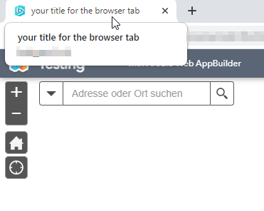

Kara_Lara
@AndreasEugster thank you so much! This worked out perfectly.
MichaelLev
Dear Kara_Lara,
In the config.json there is a line
"title": "ArcGIS Web Application",
What yoy have to do is to add a line (next to it, for example):
"titleBrowserTab": "here you write what you want to be in the browser tab title",
