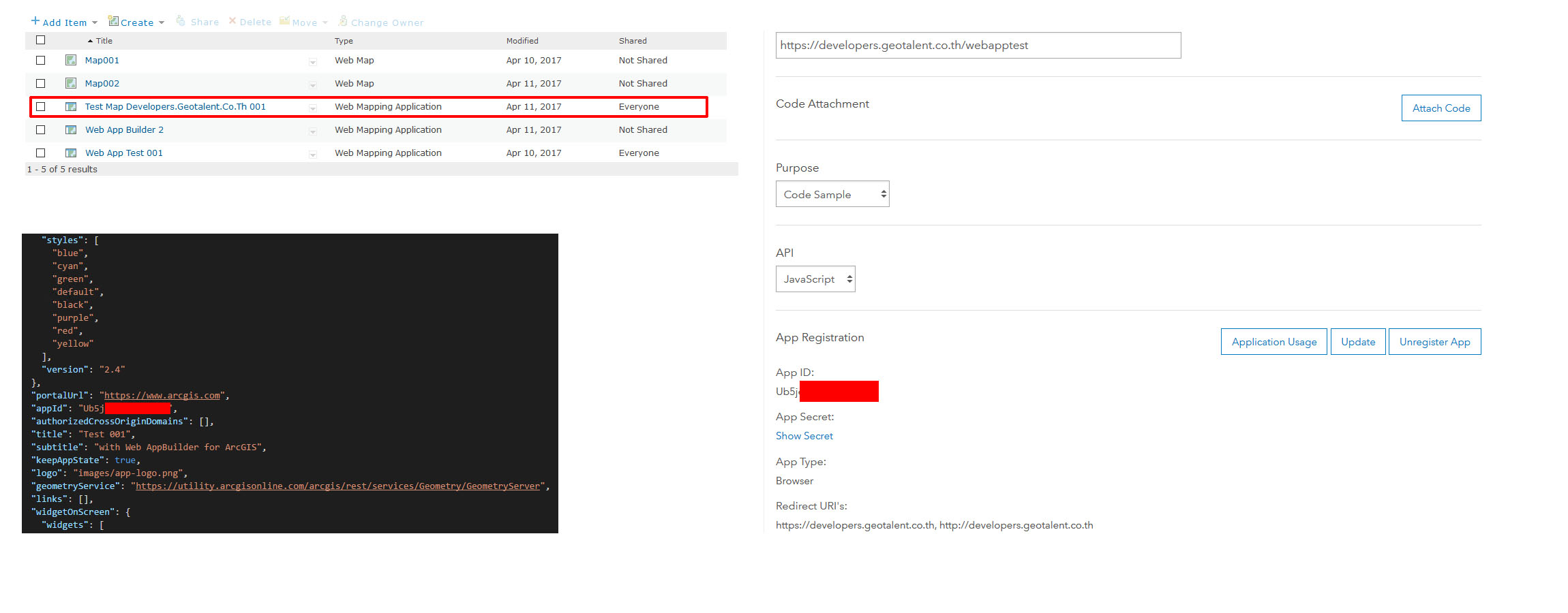

I already deployed web and tried step 5 and 6 something like this. Is this correct?
WoraminSattayatharn1
Solved It. I need to set sharing to public on the map itself too.
