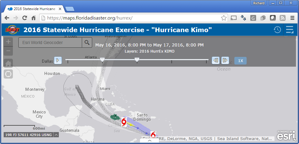

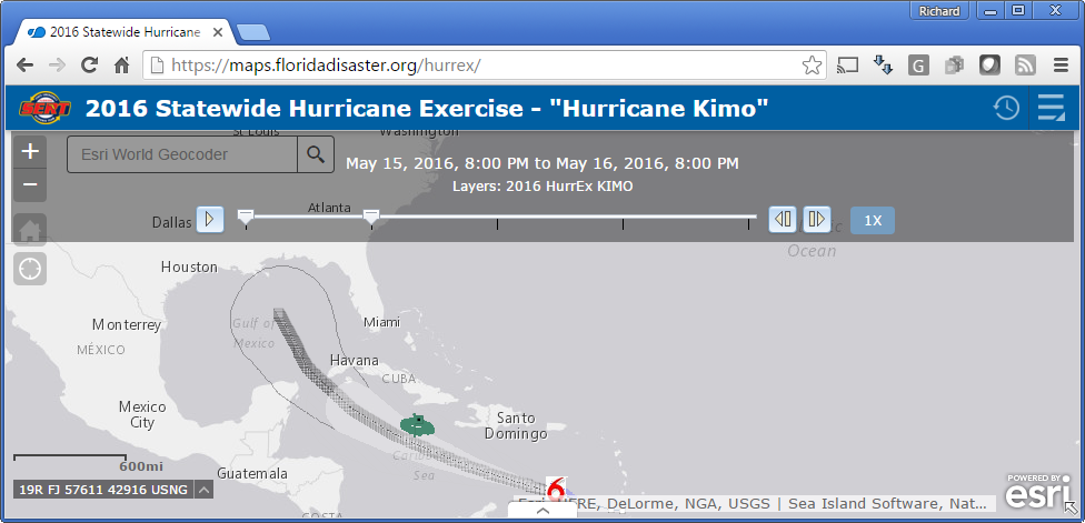

Except -- note how the Time Slider has two handles on it to set the duration of the time displayed -- from May 15, 2016, 8:00 PM to May 16, 2016, 8:00 PM. That isn't a problem on Day 1 of the exercise.
But on Day 2 -- it is, because now the map is displaying 2 current locations and 2 forecast tracks.

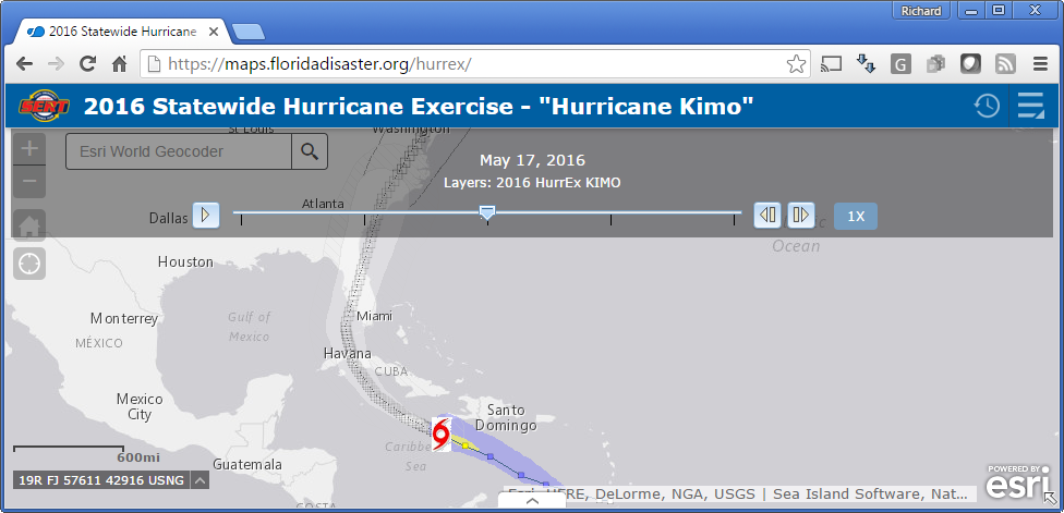

The solution is, of course -- to close up the 2 sliders, to display only 1 day like this --
There -- that's perfect for Day 2 of the exercise.
