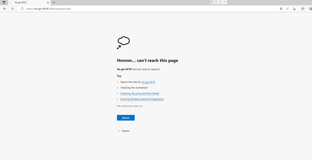

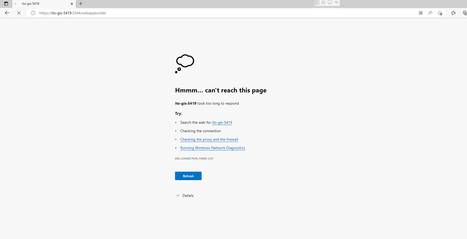

The user is using Web App Builder Developer edition for creating customized WebApp. Everything was working fine and all of a sudden the batch file stopped running where the it automatically picks machine name (Screenshot1):

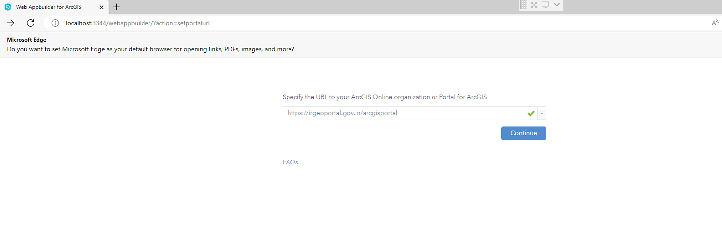

It also did not work with FQDN and IP as well. But it did work if it was replaced with localhost (Screenshot2)

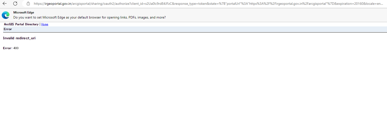

But after clicking on Continue on the above screen, it gives the below error of Invalid redirect url.

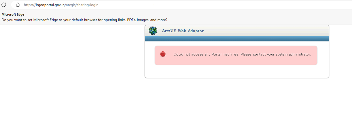

And when we try to log in from the top right corner of the above screen, it throws the below error:
The thing to notice is: The Web Adaptor for the portal here used is: arcgisportal as you can see in the 3rd screenshot but then trying to login it changes the WebAdaptor name to arcgis and thus gives this error.
