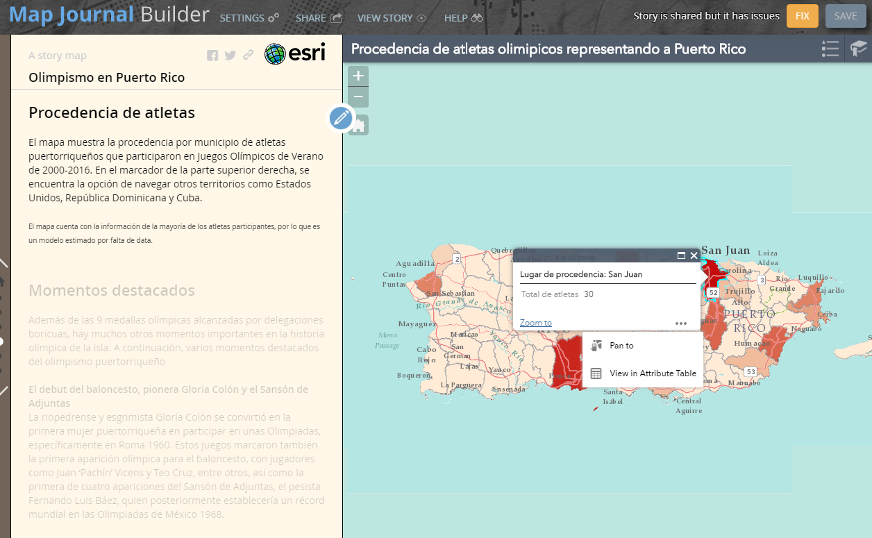

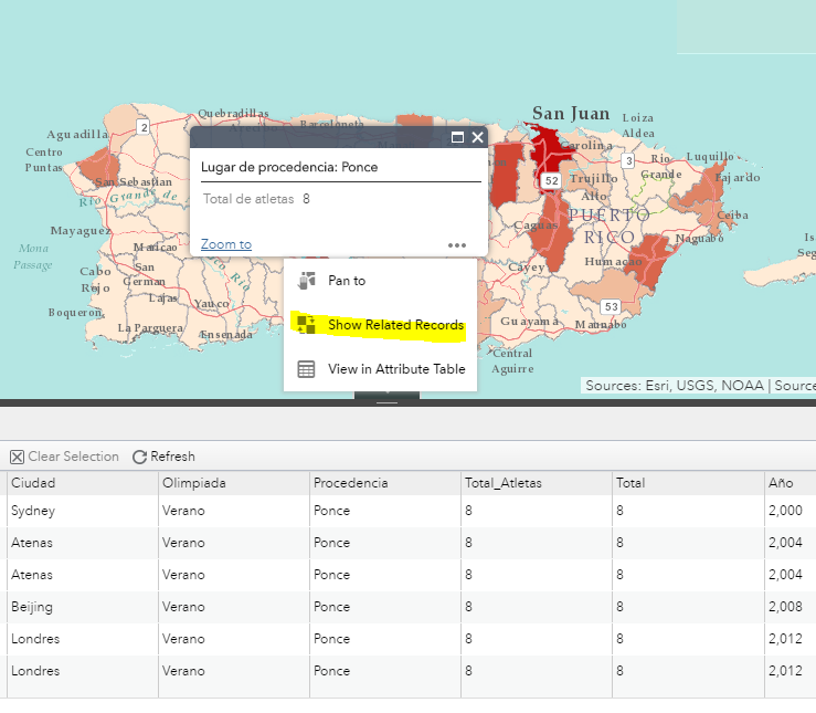

Hi,
I have a web appbuilder map with related records. When I use my map using just the WAB app I can see the option Show related record.
Once I embed the app into a Story Map Journal I don't have the show related records option
Is there something I can do about this problem?

Hi Owen,
I figure out the problem. When I use embed option by default it mark the option "Load page over a secure connection (HTTPS)
After remove the s from the embedded code
and the option it worked fine. I was able to see the option show related Records.

DiegoLlamas
Hi Owen
I have tried to add a url and an embed page in the Story map Journal with the same result
Story Map, in the 5th bullet https://atlaspr.maps.arcgis.com/apps/MapJournal/index.html?appid=21b5e229dc504c1cb6e32accc3cd61d1
