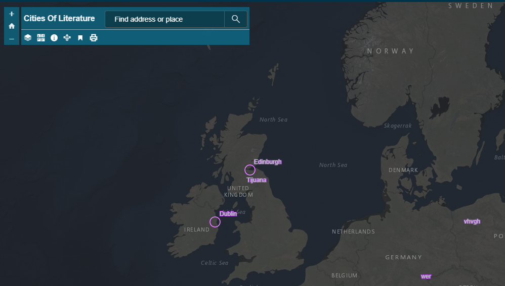

I recently completed a Web Application (Developer Edition) and am now trying to embed it in a website. I followed the steps, copied the below HTML code, and the app that loads is a 'Cities in Literature'.
```<style>.embed-container {position: relative; padding-bottom: 80%; height: 0; max-width: 100%;} .embed-container iframe, .embed-container object, .embed-container iframe{position: absolute; top: 0; left: 0; width: 100%; height: 100%;} small{position: absolute; z-index: 40; bottom: 0; margin-bottom: -15px;}</style><div class="embed-container"><iframe width="500" height="400" frameborder="0" scrolling="no" marginheight="0" marginwidth="0" title="Data Map" src="https://arcgis.com/apps/View/index.html?id=220675e23d3b48e6a8de854b669bf6ea"></iframe></div>```

The id you generate using the Web App Builder will only work with Web App Builder apps. The app you linked to above is not a Web App Builder app so it doesn't understand the id from a WAB app.  Here's info on how to create a web app builder app in ArcGIS Online: https://doc.arcgis.com/en/web-appbuilder/create-apps/make-first-app.htm

The issue is the id url param with that particular app.  That application is a configurable app called "Basic Viewer" not Web App Builder.  That app accepts either an application id for a config app or a webmap id. You can configure your app using the version available in ArcGIS Online then use the id in your embed. Or you can pass in the webmap id by setting the url param as follows:
Appid example:
https://www.arcgis.com/apps/View/index.html?appid=enter some valid appid here
web map:
https://www.arcgis.com/apps/View/index.html?webmap= enter a valid webmap id

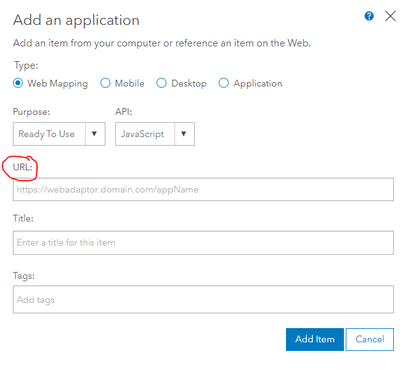

I created the app in Web App Builder (Developer Edition). When I launch the app in Web App Builder the link in the address bar is "'mynetworkurl'.3344/webappbuilder/apps/4/"
Through My Content, I then selected 'Add an Application' and inserted the above Url into the 'URL' field, which generated the App ID I posted in my original email.
Is this the correct way to do this or should I be doing something else to an appID I can embed into a website?

I don't think I was clear enough in my original question. The 'Cities In Literature App' is not my app, I assume it's someone else's or a generic Esri template. This is one that loads when I input my own App ID.
Perhaps I'm doing something wrong in the steps I outlined above,  to generate a workable App ID
