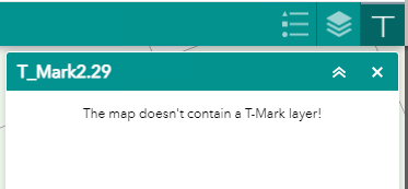

this shows the widget saying it does not contain a layer.

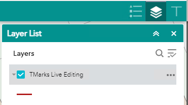

this shows the hosted feature layer within the web app test build

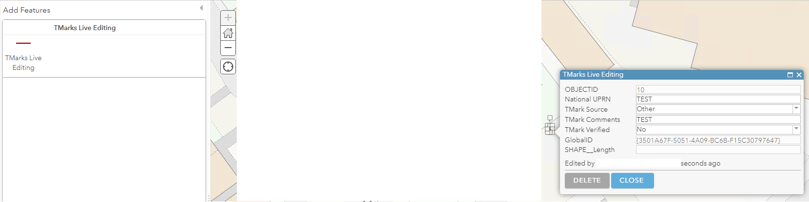

this shows it within a web map and able to edit manually and draw lines, but the widget would when selected draw a pre defined shape on the map using the fields we have in the table rather than having non uniform lengths and incorrect data.
When we combine the map, the widget together it doesnt work and the widget cannot find the layer and carry out the specific actions we want it to.
