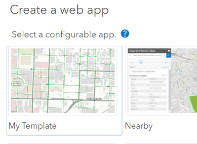

Have you replaced the configurable apps default group with one of your organization groups in Settings > Map > Configurable apps?
Once you share your template to the configurable apps group, it should then appear as an option when you create a new app from Content > Create > Configurable apps:

Thank you. i did set up a new group, called it "Configurable Templates" and set it as the repository  for configurable apps and yes my template shows up now but it still only gives me the option to view and share.
Thank you
Edit:
Ok i think i got it now. i cane see it when i go My Content > Create > Web App.
Now i just have to play with and  make sure i set up the configuration correctly.
