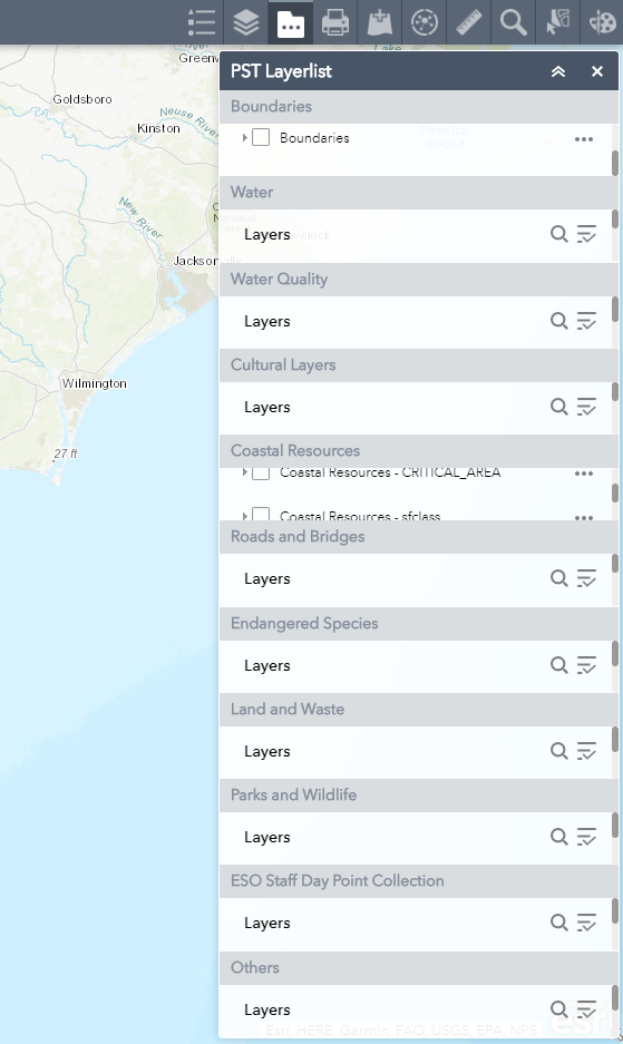

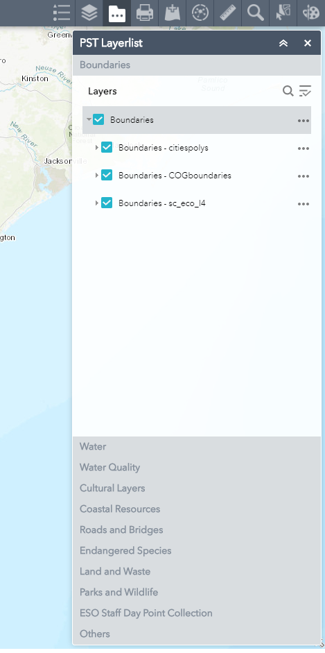

I managed to have a grouped layers list, however, the problem I have is that when I use the "openAll" option (not the drop-down option), and because I have so many groups, when I start the app it shows all the groups open (first figure). I can collapse them manually (figure 2), but I am trying to find out how can I have just one expanded when I start the app?

Thanks, Robert Scheitlin, GISP. I exactly did what you said, and also checked these codes as well (https://community.esri.com/thread/237493-is-it-possible-to-collapse-multiple-layer-lists-by-default ). I still get strange results, where the titles of all my sub-groups are gone!

I exactly have the same code there:
Still, I am getting the strange behavior from this though!

When I start the app it seems it wants to load it as I want (we expect), but suddenly it goes wrong:((
