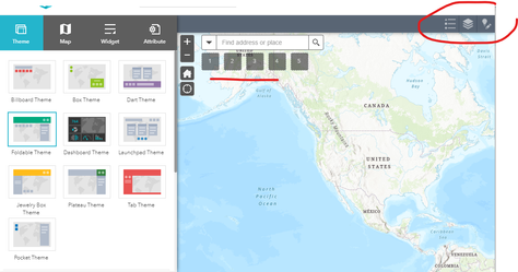

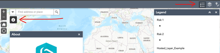

Right now, you won't be able to customize the Legend widget out-of-the-box, but as you mentioned you can use the About widget and add an image to it (like the image "After" you have attached to your post above) and use the About widget as a Legend instead (that is assuming your Legend will not change over time). There may be a way to add your images if you customize the widget code if you are using the developer edition, and I hope someone else can jump in to help with that.
Regarding "Web AppBuilder templates do not allow more than one pop-up to be open at one time" - this depends which template you are using. Some of the themes will have two widget "controllers", for example below the Foldable Theme allows you to add widgets in the Header and under the Search bar.
If you add your widgets separately in those sections, you will be able to open both when the application loads. For example:
