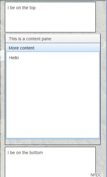

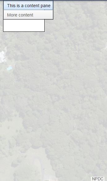

I have a border container that is not displaying its content panes correctly until I open the Developer Tools console. Can anyone see why that might be happening? I've inserted two screenshots showing before and after display states of the container.

Before:
After:
