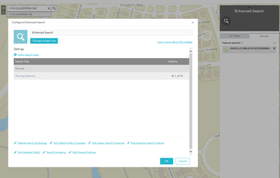

Is there a setting within eSearch that will allow for search results from multiple layers to be displayed in the results window?  So for instance, I am searching against Parcels and Zoning Districts (two polygon layers) and when the search is conducted only the Parcels layer is appearing in the results window:
If I change the order of the search layers, the Zoning Districts layer is returned in the results window:
RobertScheitlin__GISP
MVP Emeritus
Andrew,
  Nope the eSearch is only designed to search one specified layer at a time.
